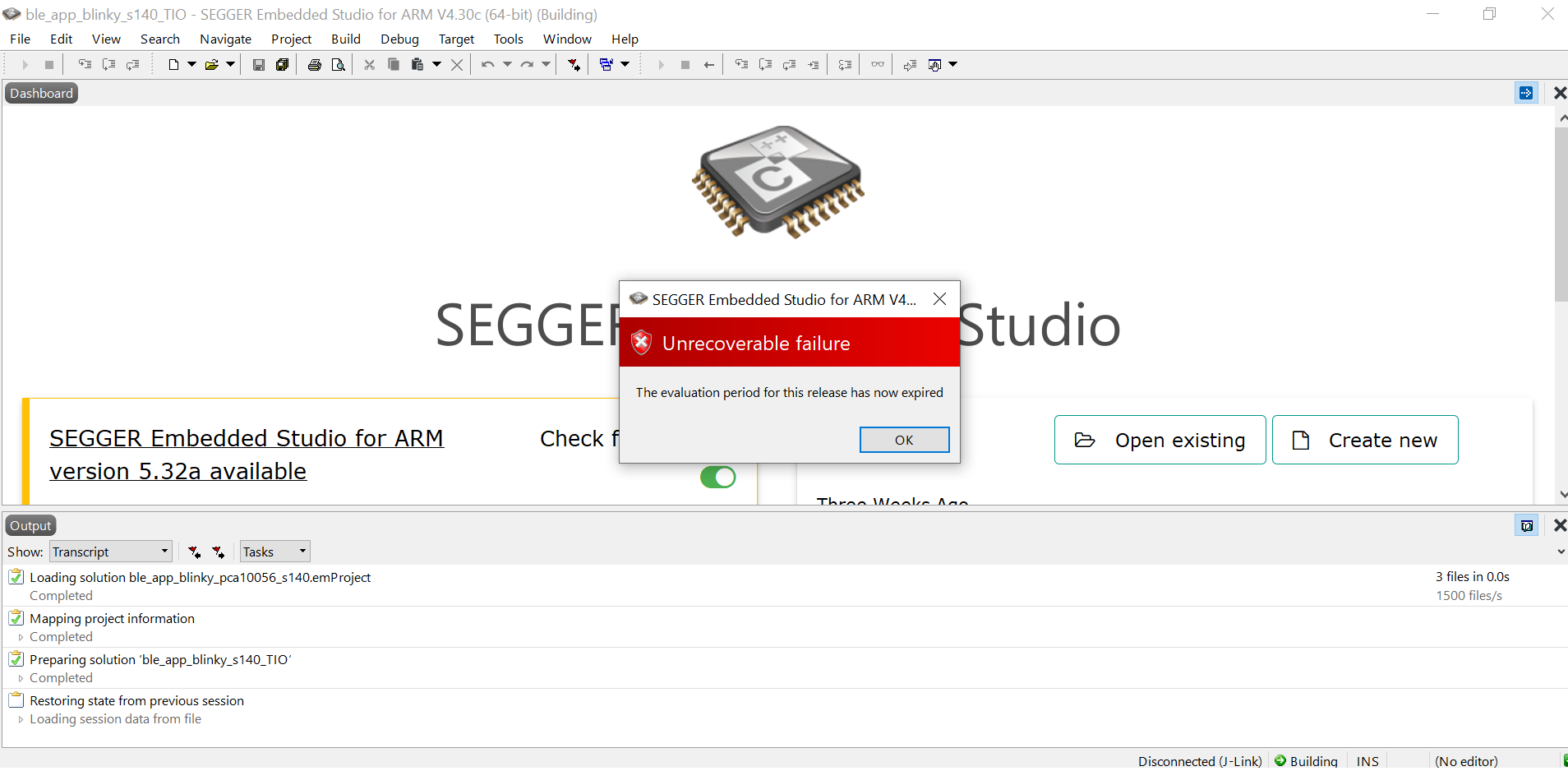

I am using nRF52840 chipset and I was using the Segger tool chain properly. But recently I started getting below error "The evaluation period of this release has now expired".
Anything to be updated.

Do you have an active license for SES?
I see that you're using v.4.30c, could you try updating to a newer version?

Thank you for your inputs.
Do I need to uninstall old one and install latest Segger version or is there any way to update to newer version.

I would recommend uninstalling the old one and installing the latest version from their download page.

Thank you its working now.
