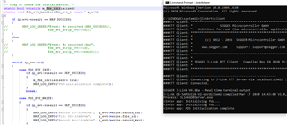

FDS events are not receiving in freertos project
I am using nrf52832 development board with sdk 17.0.2 and softdevice 132.
I have freertos project which had ble nus service and aes cbc logic added to it.
I have added fds logic from fds example code.
FDS events such as init, write are not receiving.
Could you please help?
    Please make sure you have included the nrf_sdh_soc.c (nrf_sdh_soc component) in your project, and if you already have, place a breakpoint in  nrf_sdh_soc_evts_poll() to see if it ever receives any SoC events from the Softdevice (NRF_SOC_EVTS)
    Vidar

    /* Flag to check fds initialization. */
    static bool volatile m_fds_initialized;
    static void fds_evt_handler(fds_evt_t const * p_evt)
        if (p_evt->result == NRF_SUCCESS)
    //        NRF_LOG_GREEN("Event: %s received (NRF_SUCCESS)",
    //                      fds_evt_str[p_evt->id]);
        else
    //        NRF_LOG_GREEN("Event: %s received (%s)",
    //                      fds_evt_str[p_evt->id],
    //                      fds_err_str(p_evt->result));
        switch (p_evt->id)
            case FDS_EVT_INIT:
                    m_fds_initialized = true;
            case FDS_EVT_WRITE:
                    NRF_LOG_INFO("Record ID:\t0x%04x",  p_evt->write.record_id);
                    NRF_LOG_INFO("File ID:\t0x%04x",    p_evt->write.file_id);
                    NRF_LOG_INFO("Record key:\t0x%04x", p_evt->write.record_key);
            } break;
            case FDS_EVT_DEL_RECORD:
                    NRF_LOG_INFO("Record ID:\t0x%04x",  p_evt->del.record_id);
                    NRF_LOG_INFO("File ID:\t0x%04x",    p_evt->del.file_id);
                    NRF_LOG_INFO("Record key:\t0x%04x", p_evt->del.record_key);
    //            m_delete_all.pending = false;
            } break;
            default:
    /**@brief   Wait for fds to initialize. */
    static void wait_for_fds_ready(void)
        while (!m_fds_initialized)
    		int ocunt;
    		ocunt++;
    /** @brief Application main function. */
        ret_code_t ret;
        ble_stack_init();
        // Initialize.
        log_init();
        timers_init();
        buttons_leds_init();
    //    ret = nrf_drv_power_init(NULL);
    //    APP_ERROR_CHECK(ret);
    //    ret = nrf_drv_clock_init();
        ret = nrf_crypto_init();
    #if NRF_CRYPTO_BACKEND_MBEDTLS_ENABLED
        ret = nrf_mem_init();
        /* Register first to receive an event when initialization is complete. */
        (void) fds_register(fds_evt_handler);
        NRF_LOG_INFO("Initializing fds...");
        ret = fds_init();
        /* Wait for fds to initialize. */
        wait_for_fds_ready();

    Hi Vidar,
    I kept a breakpoint in nrf_sdh_soc_evts_poll() function.
    It never reaches the breakpoint.
    sharing main.c for reference.
  • Hi Vidar,
    Yes after removing it in main(), fds initialize event received.
    But when i added fds write function after nrf_sdh_freertos_init() function, i am still not receiving fds_write event.
    Please confirm if the write function is returning an error code or not.
  • no error with write function.
    I see that if i dont wait for write event on while loop, i am receiving write event.
    But i have to read the data back as soon as i write data..
    In that case, what has to be done?
  • You will not receive any events until you start the Freertos scheduler. Maybe you can do the write from a task instead?
  • That is ok..
    But i want to immediately read after write... And read should be done only after i receive write event..
    But if i'm waiting in  while loop for write event to be successful, softdevice task wont run parallely and events wont receive..
    How do i do that? How do i read immediately after write?
    Please help..
    If possible, please help me with an example..
