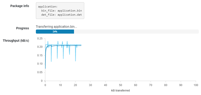

I am preparing Windows desktop application which will use nrfutil for DFU of the products (containing secure dfu bootloader). I tested nrfutil v6.1.0, v6.0.1 and even very old v3.2.0 and in all cases update takes very long time - 100 kB firmware is updated in more than 10 minutes. If I do it via nRF Connect app on iPhone or Android, it tooks literally tens of seconds. I tried also nRF Connect for Windows and the situation is the same, also about 10 minutes. I tried it on nRF52832 DK, nRF52833 DK and nRF52840 DK, results are the same.

     You are not wrong. I believe the problem with Windows is that the USB commands and responses are sent and received too slow. The required USB bandwidth is not much, but latency is more critical as the interface protocol requires transmissions and reception of many small packets.
