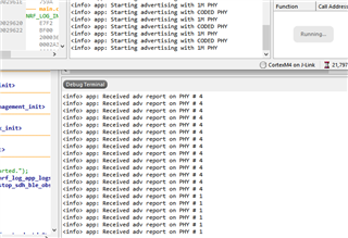

    Attached below is the projects I made to test this. Could you go over those and possibly try them to see if it works on your side as well?
    Test projects based on nRF5 SDK 15.2.0/s140 v6.1.0
    ble_app_beacon_adv_ext.zip
    ble_app_beacon_scanner.zip
    Excepted log output from the scanner and beacon in SES
