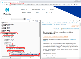

So can any other Centrals "see" your phone when you think it should be advertising?
Can your Central "see" any other advertising peripherals?
What code are you using in your Central? The CLI example is a good one, as that can list all the advertisers the Central is "seeing" ...
Yes, it see beacon that has nRF module devices.
I use ble_app_uart_c for my central.
CLI
How can i find that example?
CLI = Command Line Interface:
Thanks a lot! I’ll search and try it.
