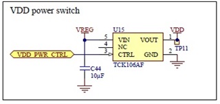

thingy52 fail to update
I don't know what happened to my thingy 52 after lots of firmware updates with Keil+Jlink+thingysdkv210 and nRF connect operations. The LED on thingy isn't flashing any more and device memory layout is unable to fetch on nRF connect as well. I tried to do DFU through mobile app by pressed the button but fail to find the thingy52 device. I don't have a nRF52 DK for updating but with J-Link + Keil instead.
what can I do to solve this question?
It looks like an nRF52 DK is necessary to update thingy52 with nRFgo Studio. Is it correct?
best wishes,
Frankie
  • Hi Kenneth,
    I still got error by installing a newer version of nRF command tool. The older one is 8.5.0 installed during nRFgo installation.
    D:\>nrfjprog --version
    nrfjprog version: 10.12.1
    JLinkARM.dll version: 6.88a
    D:\>nrfjprog --recover
    ERROR: JLinkARM DLL reported an error. Try again. If error condition
    ERROR: persists, run the same command again with argument --log, contact Nordic
    ERROR: Semiconductor and provide the generated log.log file to them.
    D:\>nrfjprog --recover --log d:\
    ERROR: Low voltage detected at the target. Please make sure the device is
    ERROR: properly supplied.
    I got 3.49V from VREG.
    BTW, My thingy52 's VDD is 0V and VDD_PWR_CTRL is low. Is it correct?
    attached the log file for your reference.

  • Hi Kenneth,
