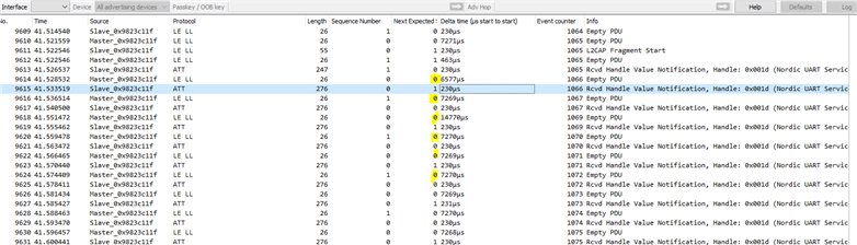

  • Looking at the PCA10059 Trace you can see once the Data Transmissions over the NUS Rx char start there is a Notification Send every 12~14msec as expected.  The payload should be 243bytes grabbed from an IMU FIFO.  However once I hit the first NRF_ERROR_RESOURCES @41.526 and enter my wait loop,  this loop iterates at the Connection Interval (7.5msec) and seems to keep resending the same payload.  Since my system never receives the BLE_GATTS_EVT_HVN_TX_COMPLETE event this loop spins forever.  So the underlying issue is eventually the BLE_GATTS_EVT_HVN_TX_COMPLETE event stops firing.   Could this be an issue due to using FreeRTOS?  I see that under the hood it uses Event Polling for Stack events rather than interrupts.  I manually set the SDH task priority to assure its the highest in the system (currently at 10).  Also note all my data sends are from Task context of a task with Priority 6 (lower than the SDH task).

  • Hi Dave,
    Having a look at 41.526 I can see that it was the PCA10059 NACKed the notification from the DUT.
    You can find the NESN (Next expected sequence number) of the packets from PCA10059 remains at 0 in all the packet after 41.526. ( I have some explanation on how to read SN and NESN here at the bottom of  the blog).
    This explain why you see the DUT sending same notification after that, when a packet is NACKed, the device need to resend the same data again.
    So the issue might not be on the DUT but on the PCA10059. This may explain why you don't see the issue when testing with the Samsung tab.
    So we need to look into what you run on the PCA10059, there could be a chance that we have an overflow on the dongle. If the RX buffer on the dongle is full and the application doesn't pull the data out, the dongle will start nacking.
    This happened at the same time when we receive a "L2CAP fragment start" so I'm not 100% if that the cause of the issue. If you can capture some other traces we can check the pattern and see if it's the cause. However, there were several L2CAP fragment packets before and it worked fine so I don't think it's the problem.
