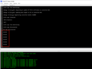

Have you seen that the log message "<info> app:Disconnected" twice? And the message is lost some sentence.
That means you didn't NRF_LOG_FLUSH() when you update the NRF info.
