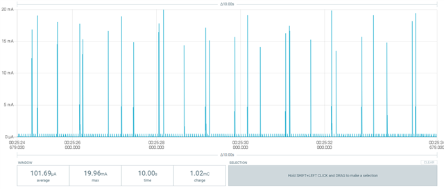

describe my device first:
A Temperature and Humidity Sensor(twi)  measure every second
nrf52832 module
it has an lcd and its control IC(twi),
a spi flash to store data
Scheduled to use two 1.5V Carbon zinc battery in series
I just got my ppk2 few hours ago
and i measure the power of my device with source meter mode
i got my power consumption : 100ua when not connecting to phone
i have done to my code:
1.use external oscillator
2.turn on dcdc regulator
3.uninitial spi,twi,saadc when not using them
4.set the adv interval to 375ms
Question 1
should i not use source meter mode when measuring ?
maybe i should  Install the battery and use ampere mode?
Question2
IS that power consumption good enough?
  • IS that power consumption good enough?
    Good enough for what ?
    The important thing to remember about batteries is that they provide a finite amount of charge (ie, energy).
    So your job, as designer, is to ensure that the amount of charge your product uses will give you the required run-time from your batteries.
    The display shows you charge here:
    Carbon zinc battery
    that's not a good choice for long life - alkaline would be better
