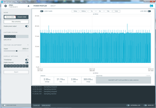

I got it PPK2 and tested.
PPK2 is very useful compare to previous version PPK.
I wanted to sampling time expanding to 10min.
But i see that 2min time sampling limit.
How to expanding sampling time more?

Most probably, the max time is limited due to the high amount of data. I've notified the PPK team.
Meanwhile, you can use Python to achieve this yourself if need be, by running a continuous data capture and processing measurements: github.com/.../ppk2-api-python
