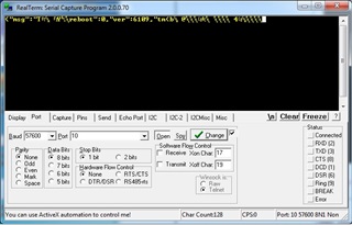

I have a strange problem at the moment. I am currently using the USBD_CDC_ACM driver on the nRF52480 dongle hardware. Software SDK version is 15.2. Softdevice S140
The application basically sends plain text data packets to a serial terminal. If I compile the application in SEGGER Embedded Studio the transmission of data works fine, but the same code compiled under Keil I get some wrong characters coming out on the terminal as shown in the picture below.
Do you have any ideas on how this can occur? I suspect is something to do with flow control. I tried to look in the driver to see where the communications parameters are set in code but are unable to find them. Can you please lead me into the right direction.

  • May you show the CDC driver in your side? Your project example is the baud rate 57600bps. The json message data seems like some how the parity or  bit timing issue. I have no idea about that.
  • Hi Henry,
    I am not sure what you want to see but here is the setup of the CDC driver. I can't show too much of the code because it is company code and can't share in a public forum. The code is based on the usbd_ble_uart example all of the settings are default. How can I hard code the baudrate parity and handshaking for the CDC driver? I can't seem to find code to do that in the examples. Under Segger environment everything works well.

  • Hi! Jes:
    It's okay. However, the debug rule is quite different between different IDE.
    It seems like okay. In your initialization. But I applied CDC in keil & SES C before. I think the driver is okay. So that I doubt the bug in your side. But my SDK version is 17.0.2.
  • Hi Jes
    How is the data generated on the nRF52 side?
    Is it all generated locally, or is it based on some sensor sampling or similar?
    Are you able to reproduce the issue with the standard CDC example, or is the code very different?
    Have you tried to reproduce it on the nRF52840DK?
