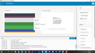

    We are using SDK16\examples\iot\bootloader\pca10056\s140\ses with our own application which is based on COAP. It is based on background dfu module download and stored the application file into flash memory(BANK1) in case of dual bank update.
    But this time i came with new problem in which, after successfully downloaded and stored the dfu package using background dfu module nrf52840 is reset by the application using NVIC_SystemReset() inside dfu_observer function when the callback notify NRF_DFU_EVT_DFU_COMPLETED.
    But there is no swap operation(DFU Application not moved from BANK1 to BANK0) is occurred after reset.
    The current application(BANK0) again run and the dfu Application is also present in BANK1.
    As you can see in the image file which i attached below.
    We already tested to set this macro NRF_DFU_IN_APP 1 in both, application SDK.config.h and bootloader sdk_config.h file.
    Also tested to set this macro NRF_DFU_IN_APP 1 in application sdk_config.h  and NRF_DFU_IN_APP 0 in Bootloader sdk_config.h file.
    Please help us to solve this problem, we are so closed to update firmware using coap.

    As I understand it you have successfully copied in place the new application in bank 1, but it is not activated (copied in place etc). Is that correct? If you are doing as the example application (examples\iot\tftp\background_dfu\main.c) and TFTP DFU module then this should work out of the box. Can you share a debug log and your code so that I can better understand?
    Yes, you are right.
    We are using same background DFU module but we created CoAP DFU module instead the use of TFTP module. The CoAP module is same as present in thread DFU application in ZigBee SDK.
