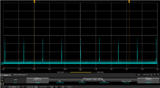

Please, the consumption is about 5mA when connect and bonded ?
or not
tks
or not
tks
Hi, which SDK version are you using?
16! Some suggestion? Consumption is about 15mA, not 5mA that I said
Or, only say me wich the common consumption after connection
The current consumption is about 50 uA after connection. So I think your measurement setup is incorrect. Please describe your measurement setup.
Thank you so much!
I am using the JAVASCRIPT to program it! It´s working! 240uA consumption is good for me!
