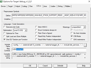

need to support character pointers with 32-bit width in thingy52 FW
I add a compiler flag --wchar32 in the Misc. Controls section of C/C++ to support character pointers with 32-bit width. But got errors as log attached. Any help is appreciated
thanks
