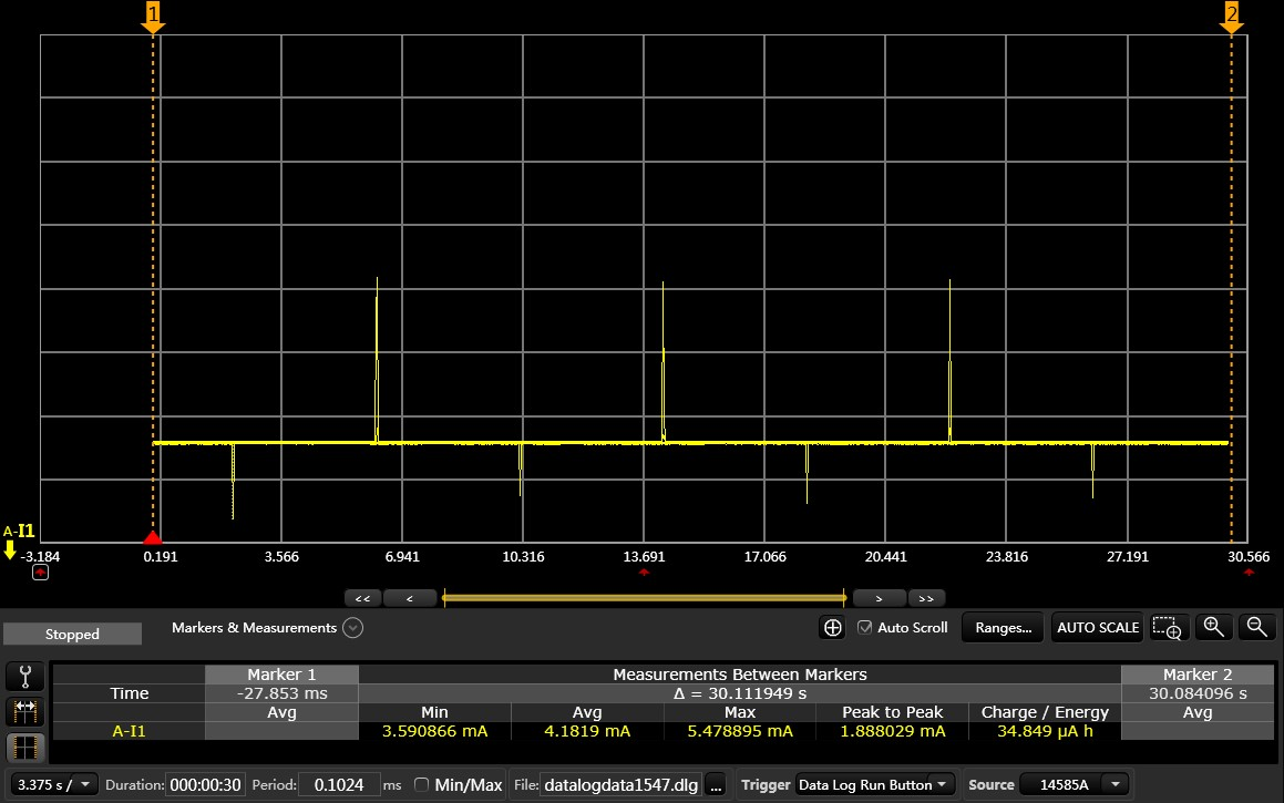

Does the ble_app_uart_c routine, without serial port initialization, affect the scan?
我正在执行ble_app_uart_c例程的功率测量,并且已经关闭了串行端口,这与打开串行端口时测量的波形不同。我猜封闭的串口会影响扫描。

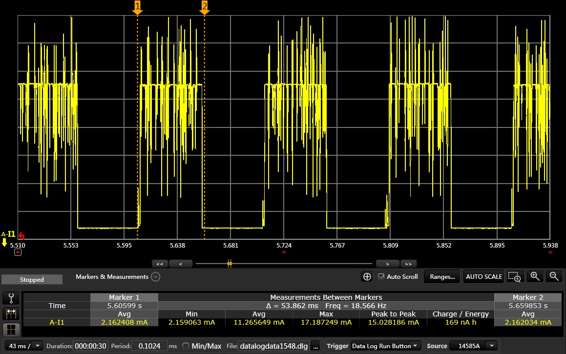

This is the waveform without closing the serial port
This is the waveform without serial port initialization
  • Why the current without UART initialization is lower than normal?

    I wonder that the difference just UART is working or not.But the time period of scope is different. The main current consumpion may not be cause by the scan ble event.
    個人認為差異只是剛好串口有無作動而已,但實際脈衝周期似乎也有明顯差距,可能的原因也許變動的電流脈衝並非主要是scan ble的工作電流造成。

    Finally, how can I check if the power I measured is normal? Scan.
    This viewBut the results I got were a lot different from what I had measured.
  • The peripheral is not connected.It may be some reasons. Is it the service UUID matched and the scan filter suitable? And you can trace the central side without UART initialization scan_evt_handler();ble_nus_c_evt_handler();db_disc_handler(); is okay or not.
    If the event handler is not working, you can't expect the power consumption is follow the power profile.
  • I initialize the UART, and then close the serial port app_uart_close() after the scan start. It seems that if uART is not initialized before scanning initialization, it will lead to no scanning. I don't know what UART has to do with scan initialization.I'm normal now.
