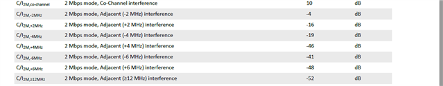

nRF52833 RX selectivity issue
Hi Team,
Why the RX selectivity performance is different on -MHZ and +MHz?
As I know,  Rx selectivity (or call adjacent channel rejection) performance shall be equal or close on -MHz and +MHz test conditions.
Notice: above picture come from the nRF52833 datasheet
Thanks
