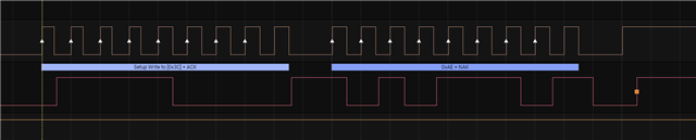

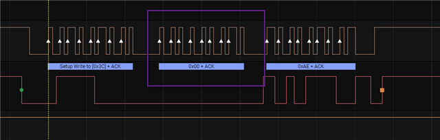

I am trying to communicate with a SH1106 OLED display using TWI and the popular u8g2 display controller library.
I've verified that the display works without problems on an Arduino and I now try to mimic the exact same behavior on the nRF52. In order to be sure the TWI is correctly configured I first search for the component based on the code of the TWI scanner. This is successful and the OLED device is found at the well-known ID 0x3c. Then I am using the u8g2 library to communicate with the display.
Basically you have to implement some cases in a user defined function and register this as handler (u8x8_HW_com_nrf52832 and u8g2_nrf_gpio_and_delay_cb).
I think the background here is not too important for the problem at hand, as the error happens from within nRF code and not in the library, so we know exactly which arguments are passed to the nRF API.
The problem is that on the first sending of data the nrf_drv_twi_tx() functions throws a Fatal Error thus crashing the application.
I've printed every buffer which is handled by the function to illustrate the problem and would like to understand what's going wrong.
I have based my experiments on the TWI scanner example and use the TWI in *blocking* mode to keep it simple at first.

<info> app: Dumping send buffer of len 25 ('buf_idx')
<info> app:  AE D5 80 A8 3F D3 00 40|....?..@
<info> app:  8D 14 20 00 A1 C8 DA 12|.. .....
<info> app:  81 CF D9 F1 DB 40 2E A4|.....@..
<info> app:  A6                     |.
<info> app: Now calling 'nrf_drv_twi_tx(&m_twi, 60, buffer, buf_idx, false)'
<info> app: errcode = 0x33282
<error> app: Fatal error
What could be the root cause for the Fatal Error when trying to send those 25 bytes?
As said: The scanning for the device ID at the start of the program works! So the GPIOs, the frequency etc. should all be ok?
Do I have to call some other API before doing a nrf_drv_twi_tx()? If yes, which one?
