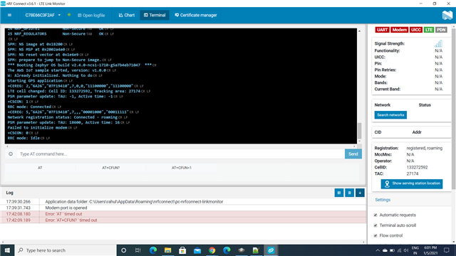

    SO I tried to merge the AWS_IOT sample and GPS code. In both the code they have initialized the modem. Shown below:
    From GPS sample
    	if (init_app() != 0) {
    		return -1;
    From AWS_IOT sample
    #if defined(CONFIG_BSD_LIBRARY)
    	modem_configure();
    	err = modem_info_init();
    	if (err) {
    		printk("Failed initializing modem info module, error: %d\n",
    			err);
    	k_sem_take(&lte_connected, K_FOREVER);
    While I am calling both in the main function getting a "failed to initialize modem" error.
    Can you help me out to solve the above error
    With regards,
    Rahul Kidecha
  • Hi Hakon,
    Thank you for your reply.
    I want to send the GPS data to my AWS_IOT server. I made changes in the AWS_IOT code and got connected to the server successfully. Then run GPS code both are working fine when run individually.
    As I want to send the GPS data tried to merge the code. As per my understanding, both have different modem configuration settings which not allowed to work properly.
    I have tried to arrange the modem configuration function in a different position. Sometimes AWS_IOT works fine but GPS not and vice-versa.
    If you help to configure the modem will solve the whole problem. It is kind of difficult to play with LTE and GPS as both works concurrently.

    2021-01-07T10:28:09.398Z INFO Application data folder: C:\Users\rahul\AppData\Roaming\nrfconnect\pc-nrfconnect-linkmonitor
    2021-01-07T10:28:09.421Z DEBUG App pc-nrfconnect-linkmonitor v1.1.10 official
    2021-01-07T10:28:09.421Z DEBUG App path: C:\Users\rahul\.nrfconnect-apps\node_modules\pc-nrfconnect-linkmonitor
    2021-01-07T10:28:09.421Z DEBUG nRFConnect 3.6.1 is supported by the app (^3.6.0)
    2021-01-07T10:28:09.421Z DEBUG nRFConnect path: C:\Users\rahul\AppData\Local\Programs\nrfconnect\resources\app.asar
    2021-01-07T10:28:09.421Z DEBUG HomeDir: C:\Users\rahul
    2021-01-07T10:28:09.421Z DEBUG TmpDir: C:\Users\rahul\AppData\Local\Temp
    2021-01-07T10:28:12.670Z INFO Modem port is opened
    2021-01-07T10:28:12.676Z DEBUG modem >> AT+CFUN?
    2021-01-07T10:28:12.873Z DEBUG modem << *** Booting Zephyr OS build v2.4.0-ncs1-1710-g5a7b4eb71047  ***
    2021-01-07T10:28:12.887Z DEBUG modem <<
    2021-01-07T10:28:12.889Z DEBUG modem << I: UART check failed: 1. Dropping buffer and retrying.
    2021-01-07T10:28:12.918Z DEBUG modem << The AWS IoT sample started, version: v1.0.0
    2021-01-07T10:28:12.920Z DEBUG modem << W: Already initialized. Nothing to do
    2021-01-07T10:28:12.921Z DEBUG modem << Starting GPS application
    2021-01-07T10:28:14.542Z DEBUG modem << +CEREG: 2,"8402","02055C03",7,0,0,"11100000","11100000"
    2021-01-07T10:28:14.546Z DEBUG modem << LTE cell changed: Cell ID: 33905667, Tracking area: 33794
    2021-01-07T10:28:14.547Z DEBUG modem << PSM parameter update: TAU: -1, Active time: -1
    2021-01-07T10:28:14.695Z DEBUG modem << +CSCON: 1
    2021-01-07T10:28:14.698Z DEBUG modem << RRC mode: Connected
    2021-01-07T10:28:15.837Z DEBUG modem << +CEREG: 5,"8402","02055C03",7,,,"11100000","11100000"
    2021-01-07T10:28:15.841Z DEBUG modem << Network registration status: Connected - roaming
    2021-01-07T10:28:15.843Z DEBUG modem << Failed to initialize modem
    2021-01-07T10:28:15.844Z DEBUG modem << error in init app
    2021-01-07T10:28:16.720Z DEBUG modem << DATE_TIME_OBTAINED_NTP
    2021-01-07T10:28:16.721Z DEBUG modem << Next connection retry in 20 seconds
    2021-01-07T10:28:16.725Z DEBUG modem << Getting GPS data...

    Enclosing the prj, main, and Log files.
    If you see the Log file the way I initialized the modem only allowing to run AWS_IOT properly.
