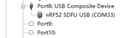

the device cant update and i can see the schedule of100%
but it cant go to the app by self ,and the strange thing is that:
1.after dfu,if power by usb ,the device cant go to the app
2.after dfu,if power by battery,the device can go to the app
so what should i do to slove this problem?"

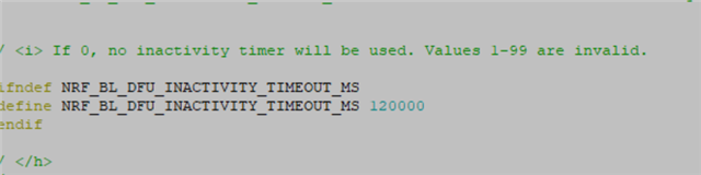

  • i test it by our board, i have not moidfiy the bootloader but public key file.
     i read the hex and  compare it,there is no different.and i discover a new case ,i use the shell command programming the app and sd and bootloader,if i powered by usb before programming,it also in the boot after programming.and if i powered by battery,it can jump to the app .and when in the boot,i trigger  the reset pin,it also in the boot.
    i debug the project,and i discover the reason of the chip cant stay in the boot is i start the wdt(2s timeout) in the app.and if i comment the init of wdt,the chip can stay in the boot ,and i can dfu.if i enable the wdt,i cant see any log of project pca10056_usb_debug.i see the wdt in the boot project,and i comment
    nrf_bootloader_wdt_init();
    in
    nrf_bootloader_init(nrf_dfu_observer_t observer)
    and comment
    if (nrf_wdt_started())
    in
    nrf_bootloader_wdt_feed(void)
    but it also cant stay in the boot,so what should i do to slove this problem?
  • You need to handle the WDT in the bootloader. Once the WDT started you can't stop it (that's the main purpose of a watch dog).
    In our current implementation of the bootloader, the wdt handling is already implemented.
    Please double check if wdt_feed() is called and the RR register you used has been reloaded. Same with wdt_feed_timer_handler() , please check if it's called periodically.
    i debug the boot , i find the wdt feed timer was not opened.and my app is the dome:nRF5_SDK_16.0.0_98a08e2\examples\peripheral\usbd_ble_uart
