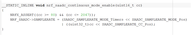

  • Hey
    Yes , the API takes care of that.
    I pass 2000 as cc upon calling the function during initialization. The following is the code for initialization function:
    bool SDL_Mic_Init(void)
      uint32_t ret_code=false;
      ret_code=nrf_drv_saadc_init(NULL, mic_callback);  //ADC Initialization
      if(ret_code==NRFX_SUCCESS)
        nrf_saadc_channel_config_t adc_channel=NRF_DRV_SAADC_DEFAULT_CHANNEL_CONFIG_SE(MIC_INPUT_DATA_PIN);
        ret_code=nrf_drv_saadc_channel_init(MIC_ADC_CHANNEL,&adc_channel);
          ret_code=true;
        nrf_saadc_continuous_mode_enable(2000); //for 8K sample rate (16000000/2000=8000Hz)
      return ret_code;
    Could there be anything wrong with the adc channel initialization in the above posted code snippet, which as you can see I have used as default ?
