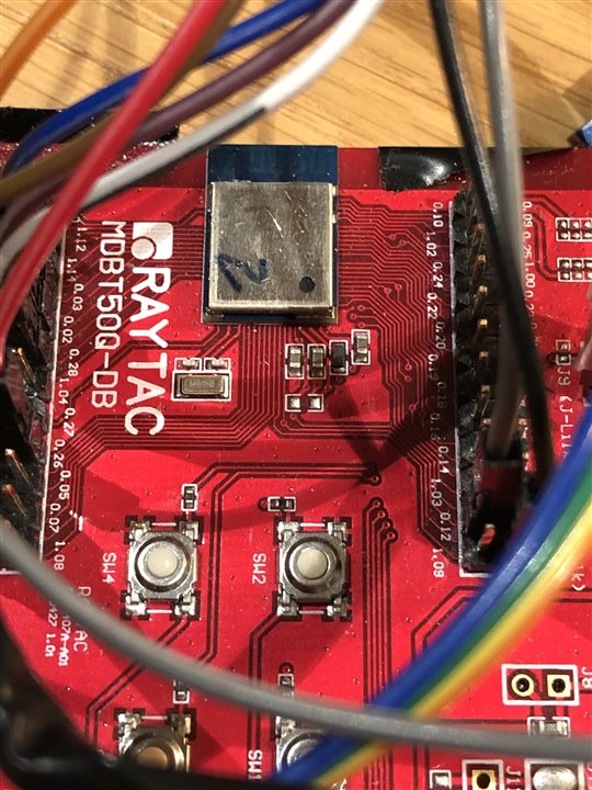

  • Here is board I am using, the pin connection should be the same, it is the MDBT50Q-1MV2 module board.
    Here is the reference   https://www.raytac.com/download/index.php?index_id=43
    Could you elaborate a bit more on how it fails? Have you tried debugging the application and checked exactly where it fails? T̶h̶e̶ ̶l̶i̶n̶k̶ ̶t̶h̶a̶t̶ ̶y̶o̶u̶ ̶s̶h̶a̶r̶e̶d̶ ̶i̶s̶ ̶j̶u̶s̶t̶ ̶f̶o̶r̶ ̶t̶h̶e̶ ̶m̶o̶d̶u̶l̶e̶,̶ ̶I̶ ̶c̶o̶u̶l̶d̶ ̶n̶e̶e̶d̶ ̶m̶o̶r̶e̶ ̶i̶n̶f̶o̶r̶m̶a̶t̶i̶o̶n̶ ̶r̶e̶g̶a̶r̶d̶i̶n̶g̶ ̶t̶h̶e̶ ̶P̶C̶B̶ ̶d̶e̶s̶i̶g̶n̶,̶ ̶s̶c̶h̶e̶m̶a̶t̶i̶c̶ ̶w̶o̶u̶l̶d̶ ̶b̶e̶ ̶e̶n̶o̶u̶g̶h̶.̶ The module doesn't have an internal low frequency crystal. Which means that you have to either provide it externally or change the Low frequency clock source. Have you done either?
    And the code you shared doesn't specify which pins that you use for the SPI as the definitions isn't included in the attached code.

    When I am using the official board all works fine, when i am using the raytac board, it never go into the interruption for reading the fifo.

    I can clearly see the low frequency crystal on my raytac development board
    Have you remembered to flash the Softdevice?
    Just to exclude any possible HW issues. Could you instead of using your application try to flash board with the unmodified SPI example from the SDK. If this example works, then we can safely assume that your issue is not HW dependent. Next, only after confirming that it works unmodified, you can try to switch the pins in the example with the pins that you use in your application.
