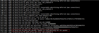

Raspberry PI MeshProxy GattService receive notification problem
I'm trying to create application for working with nRF52 device. I have completed provisioning mesh success, and receive notification message about success operation (work with MeshProvisioning GattService - ok). But when I trying to work with MeshProxy GattService, all commands (such as send AppKey, Reset or Vendor command) send's without errors, and nothing receive in notification. Why notifications not received from MeshProxy GattService?

    All the commands look like correct, but there are no messages received. In the android application, notifications for proxy-service are turning on by writing some value to descriptor. When I trying to do that - I've got an error "Write not permitted".
    Without notifications, I can't see results of my commands. I don't know the reason of that error - it's a linux problem, or it's a java problem or may be I miss some important command to send before

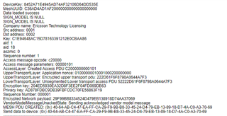

  • Error of "Write not permitted" to descriptor, may be is not a real problem. In the "J-Link RTT Viewer" I detect the problem "Unable to find matching net for packet". There is a wrong unicast address in my commands. When I set unicast address correct, some notifications was appear. Screenshot:
