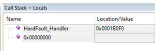

Hi all
I am using S130 SDK12, nRF51822
This is the error I am getting - line_num 0x07C0, p_file_name 0x06D1, error code 0x00D1, fault id 0x0001, pc 0x83CC (a print-screen from the debugger is also below)
The error occurred repeatedly in the same scenario
I added a notification characteristic to an existing custom service, and when the central subscribe to the notification and it is being sent the error occurs.
The error occurs only when I compile with optimization (I optimized to level 3)
    The pointers p_* are NULL, so the content is not valid as assertion info.
    The address of the assert, 0x83CC, is inside the softdevice flash area, and it is asserting on a check to see if you still have a connection.

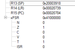

    STACK$$Length                            0x00000800   Number         0  anon$$obj.o ABSOLUTE
    After failing on the sd_ble_gatts_hvx I checked the SP, it is 0x20003918
    According to the .map file
    STACK     0x20003178   Section     2048  arm_startup_nrf51.o(STACK)
    STACK$$Base 0x20003178 Number 0 arm_startup_nrf51.o(STACK)
    __initial_sp 0x20003978 Data 0 arm_startup_nrf51.o(STACK)
    between 0x20003918 and 0x20003978 there is some space although I don't know how much the softdevice used during the execution of sd_ble_gatts_hvx  what do you think?
     This shows that there's only 0x60 bytes of stack being used, so there's no stack overflow.

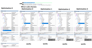

  • Hey another small note, I am now in a situation in which just adding some local variables in the function (or the function that calls that function) results in this problem, again when I am in a non optimized compilation.
    Thanks!
     Can you try comparing what goes into the sd_ble_gatts_hvx() function (in debug mode), with optimized and non-optimized firmware?
    What do you change in the optimization, is it only the level 0 to 3?
    This is a comparison I put together for the hvx_params
    So far all I have changed was optimization between 0 and 3, now I have also tried level 1 and 2, both of those optimization levels showed no problems.

    As I said, I have noticed that a minor change such as changing the order in which variables are declared, results in this failure, I compared the .hex compilation files, between one successful version and one bugged version, and it is clear that this small change in order of variable declaration caused a very dramatic change in the .hex file compilation output, altering more than half of the lines in the entire .hex files.
    What do you think can cause this?
