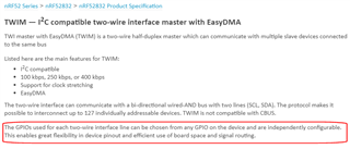

The code hangs specifically at this function :
err_code = nrf_drv_twi_rx(&m_twi, address, &sample_data, sizeof(sample_data));
Or more specifically, it never exits this block:
else

There are 4k7 pull-up resistors on the i2c device. I've checked with a logic analyzer. Both SDA/SCL are always high no matter what. The i2c_scanner of arduino nano detects the address.
