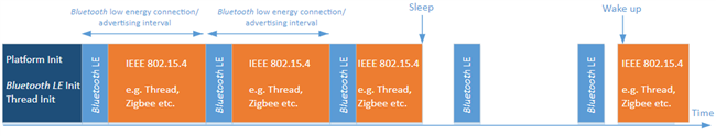

    You also mentioned that you wanted to use Zigbee in multiprotocol with BLE. In the SDK, this is done using dynamic multiprotocol, where the radio hardware is time-sliced between the protocols. We also have some Zigbee multiprotocol examples you can check out.
