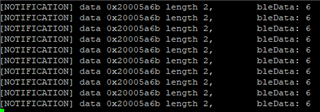

    Alright. So my understanding is what is printed is the address that stores the data. Trying to dereference it, however, gets me no further. The data was sent as u8_t, but dereferencing it as either u8_t or u16_t (shown below) gives me the following (shown further below):
    static u8_t notify_func(struct bt_conn *conn,
    			struct bt_gatt_subscribe_params *params,
    			const void *data, u16_t length)
    	if (!data) {
    		printk("[UNSUBSCRIBED]\n");
    		params->value_handle = 0U;
    		return BT_GATT_ITER_STOP;
    	printk("[NOTIFICATION] data %p length %u,\t", data, length);
    	u8_t bleData = *(u8_t*)data;
    	//memcpy(&bleData, data, sizeof(bleData));
    	printk("bleData: %u\n", bleData);
    	return BT_GATT_ITER_CONTINUE;
    Output for u8_t:
    Output for u16_t:
    What am I doing wrong?
    Looking forward once again to your answer.
  • Please check out the implementation in the Nordic example, foiund in NCS\nrf\samples\bluetooth\central_hr_coded, and it's notify_func:
    static uint8_t notify_func(struct bt_conn *conn,
    		const void *data, uint16_t length)
    	if (!data) {
    	if (length == 2) {
    		uint8_t hr_bpm = ((uint8_t *)data)[1];
    		printk("[NOTIFICATION] Heart Rate %u bpm\n", hr_bpm);
    	} else {
    		printk("[NOTIFICATION] data %p length %u\n", data, length);
    which prints:
    Filters matched. Address: ef:1d:3e:56:18:9a (random) connectable: yes
    Connection pending
    Connected: ef:1d:3e:56:18:9a (random), tx_phy 4, rx_phy 4
    The discovery procedure succeeded
    [SUBSCRIBED]
    [NOTIFICATION] Heart Rate 91 bpm
    [NOTIFICATION] Heart Rate 92 bpm
    [NOTIFICATION] Heart Rate 93 bpm
    [NOTIFICATION] Heart Rate 94 bpm
    [NOTIFICATION] Heart Rate 95 bpm
    [NOTIFICATION] Heart Rate 96 bpm
    [NOTIFICATION] Heart Rate 97 bpm
    [NOTIFICATION] Heart Rate 98 bpm
    [NOTIFICATION] Heart Rate 99 bpm
    [NOTIFICATION] Heart Rate 100 bpm
    So what you are looking for is the line:
    Without having checked, I see that data[0] is 6. I believe it is following the Bluetooth specification for the Heart Rate Service. I believe it is the location of the sensor, or some similar metadata. In fact, it is. Check out the implementation of int bt_hrs_notify(uint16_t heartrate) in hrs.c, which is used by the peripheral: NCS\nrf\samples\bluetooth\peripheral_hr_coded.
    	int rc;
    	static uint8_t hrm[2];
    	hrm[0] = 0x06; /* uint8, sensor contact */
    	hrm[1] = heartrate;
    	rc = bt_gatt_notify(NULL, &hrs_svc.attrs[1], &hrm, sizeof(hrm));
    	return rc == -ENOTCONN ? 0 : rc;
