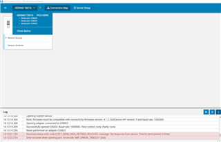

I am having some trouble on nrf5380 PDK. I can not connect it to my PC.
I attached photo of nrfconnect.
There were 3 serial ports but I have used just one which was PDK.
Please let me know, How can it be solved?
Thank you for now

The BLE app (in nRF Connect) is unfortunately not compatible with the nRF53-series. You will need an nRF52-DK.
I also recommend to get the new nRF5340-DK now, since the nRF5340-PDK is not recommended for development anymore.
