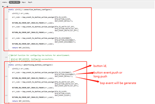

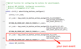

  • The key code is as below:
    here bind the button id's action and bsp event.
    `BTN_ID_SLEEP` is 0,means button1 on DK,`BTN_ACTION_SLEEP` is `BSP_BUTTON_ACTION_RELEASE`, so when
    button1 is relased in adv statue, the BSP_EVENT_SLEEP will be generate.
    If you want to generate a event just as BSP_EVENT_XXX,you can change the code to 100
    make sure that you have add the BSP_EVT_XXX to bsp_event_t 。
    Then when you press the button1 and relase it , you will get a BSP_EVT_XXX on bsp_event_handle。
