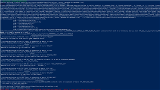

    thank you for your very good tips! I am using the correct pins now and the address of the MPU6050 is also correct.
    Unfortunatelly, it seem that I have some problems with the driver. When building the example I always get the following problem:
    Do you know that may be the solution to this problem?
    If I build the example for the nrf52 board, there is no problem. So I guess the problem is related to the adjusted .overlay file...My overlay file is this at the moment:

    I had no issues building the MPU6050 sensor sample with the overlay file. I removed the nrf52 overlay file and added:
    <NCS root>\zephyr\samples\sensor\mpu6050\nrf5340dk_nrf5340_cpuapp.overlay
    &i2c1 {
    	mpu6050@68 {
    		compatible = "invensense,mpu6050";
    		reg = <0x68>;
    		status = "okay";
    		label = "MPU6050";
    		int-gpios = <&gpio0 11 GPIO_ACTIVE_HIGH>;
    MINGW64 /c/NordicSemi/NCS/zephyr/samples/sensor/mpu6050 ((v2.4.0-ncs1))

    As I do not have the sensor here, I am not able to test this. Have you done other changes to the code?
