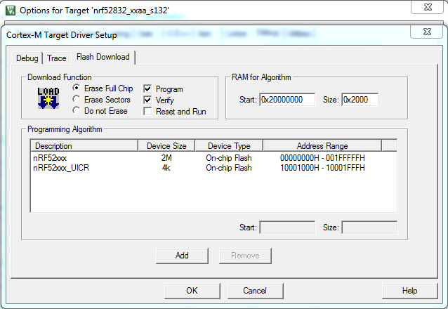

I am having problems writing to flash in an older version of s110 using the sd_flash_write() method. The question I have is when I update my code, make a new build, and download the new code to the nRF51822, does the data I have previously written to flash memory also get erased?
I am using Keil. I see that an erase is performed before the download but I don't know if that is just the code or if my previously written data gets erased as well. If the flash data I have written is NOT erased, how do I erase it? Is there a difference between the 'erase' option only and the 'download' option which also erases?
I am using flash to save bonding data. So I need to know the state of the flash when I make a new update (should I clear the bonding information on the central?).
