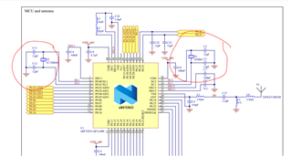

What is the main clock frequency when application is running in thingy52? Is there a way to measure it from GPIO?
BTW, want to know what is the clock source and setting for main clock frequency.
The Thingy:52 uses both the external low frequency 32 kHz crystal and the external high frequency 32 MHz crystal.
