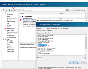

  • Hello Edvin,
    I believe i have found possible cause. The SparkFun hardware has nRF52832-QFAA 64kB. In my own hardware I have nRF52832-QFAB 32kB. I only now understood that I ordered the wrong nRF. I have read out memories from both nRFs with nRF Connect (please see screenshot). With nRF AB (32 kB) bootloader is not displayed, why? Although DFU works and the screenshots are already with the app that I flashed via DFU (please see address 0x00026000 - 0x0002C52B). App is only 25,900 bytes and should also work with nRF AB. The app does not start with nRF52832-QFAB 32kB. What do I have to adjust in order to start the app with nRF AB (32 kB)?
  • I see.
    Did it not throw any errors when you programmed the bootloader? If not, what happens if you try to read out e.g. the flash address:
    "nrfjprog --memrd 0x00078000 --n 1024"
    What is the bootloader's flash start address?
    Basically what you need to do is to change the flash addresses. If your application uses FDS (Used if you use the peer manager or any other parts that uses FDS), then make sure that it fetches the correct address.
    Depening on what IDE you are using, it is probably possible to change the compiler to set the QFAB instead of QFAA as the target.

  • So the main difference between the QFAA and QFAB is that:
    the QFAA has 512kB of flash and 64kB of RAM, while
    the QFAB has 256kB of flash and 32kB of RAM.
    Some of the QFAB chips actually has more than 256kB of flash, but the flash above the 256kB address is not tested during production, and therefore it is likely that it doesn't work as intended (normally non functional flash blocks will be replaced). This is a bit tricky in SES, but you are on the track of it.
    Settings in SES:
    These are for the QFAA:
    FLASH_PH_START=0x0
    FLASH_PH_SIZE=0x80000
    RAM_PH_START=0x20000000
    RAM_PH_SIZE=0x10000
    FLASH_START=0x78000
    FLASH_SIZE=0x6000
    RAM_START=0x20005968
    RAM_SIZE=0xa698
    If you want to run it on the QFAB, you need to change it to:
    FLASH_PH_START=0x0
    FLASH_PH_SIZE=0x40000
    RAM_PH_SIZE=0x8000
    FLASH_START=0x38000
    FLASH_SIZE=0x6000
    RAM_SIZE=0x2698
    To match the QFAB's flash and RAM.
    In addition, you should change the QFAA's:
    FLASH RX 0x0 0x80000;RAM1 RWX 0x20000000 0x10000;mbr_params_page RX 0x0007E000 0x1000;bootloader_settings_page RX 0x0007F000 0x1000;uicr_bootloader_start_address RX 0x10001014 0x4;uicr_mbr_params_page RX 0x10001018 0x4
    To:
    FLASH RX 0x0 0x40000;RAM1 RWX 0x20000000 0x8000;mbr_params_page RX 0x0003E000 0x1000;bootloader_settings_page RX 0x0003F000 0x1000;uicr_bootloader_start_address RX 0x10001014 0x4;uicr_mbr_params_page RX 0x10001018 0x4
    You should also look into your preprocessor definitions:
    You should change it to NRF52832_XXAB, but before you do, search up this definition in your projects (bootloader and application) and make sure that the equivalent of NRF52832_XXAA is implemented for NRF52832_XXAB. If it is not, please implement it. (I don't think all the implementations are included in the latest SDKs).
    Remember to set "Common" in the drop down menu before you change your settings in Segger Embedded Studio, as seen below the top red arrow in the above screenshot.
    Edvin
