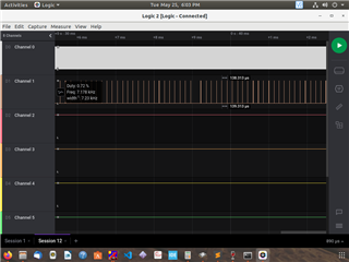

  • Hello
    I took reference from your mentioned driver's and created simple example as mentioned in my main.c code. I am interfacing nRF52840 with MP34DT05 but have issues receiving PDM data from sensor.
    Sensor takes minimum 10ms after startup to give output at PDM frequency as per datasheet but I am just receiving 16Khz frequency output from PDM senro data pin.
    I have elaborated the same below.
    Firstly i am running PDM in default configuration as you see in my code. The clock frequency is set around 1MHz with Ratio of 64x which gives around 16K samples/sec.

    I have a doubt here, shouldn't the output from sensor be 1MHz, which is than sampled by nRF52840 PDM peripheral by 64x ?
    Because when i connect my logic analyzer on CLK pin and DIN pin nRF52840 board, CLK  is 1MHz freq., but the output seen on DIN pin is just around 7KHz frquency.
    Below is the image for the refference:

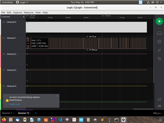

    Now when i use the configurations that's commented in the above code,
        pdm_config.clock_freq = NRF_PDM_FREQ_1280K;
        pdm_config.ratio = NRF_PDM_RATIO_80X;
        pdm_config.edge = NRF_PDM_EDGE_LEFTRISING;
        pdm_config.gain_l = NRF_PDM_GAIN_MAXIMUM;
        pdm_config.gain_r = NRF_PDM_GAIN_MAXIMUM;
    I get CLK freq= 1.2 MHz and DIN frequency around 14-16KHz. Now again my question is shouldn't my DIN frquency from the sensor PDM output  be 1MHz instead of jutst 16KHz ? which than get sampled by PDM interface at nRF52840 side.
    Have you faced any such issues while interfacing? Or do you have any idea what could be the problem here. Is it my sensor issue ?
