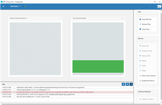

I'd like to perform a DFU through the USB port on my custom NRF9160 board (DFU over UART) using the NRF Connect Programmer App.
I already did the Firmware setup to configure MCUBoot and have seen it working with command-line tools (mcumgr) fine.
My issue here is that I see the Programmer application not enabling the "Write" button even though:
- The Board is connected through USB and in DFU mode
- The MCUBoot checkbox is checked.
- The hex image is loaded.
Here is an image to illustrate better what I mean by "Enable Write button"
I also see this does not happen when you do the same procedure with the Thingy:91.
Could you provide some assistance on what alternatives I have in order to achieve this?
Thanks in advance!
LuisF.
  • Hi!
    Unfortunately, you can't use this application to perform a DFU over USB with a custom board.. The Programmer application only supports Nordic MCUboot devices, which means the device needs to have a Nordic vendor ID and supported MCUboot product ID.
