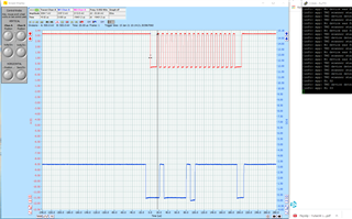

    From the code and graph, you could see that ACK is LOW for address 32 (find the device at 0x20), ACK is HIGH for address 33 (no device at 0x21).
    However, my sensor datasheet says that if I connect the sensors' ADDR pin to GND, the address should be 0x21. Very strange issue!

    Decoding this by hand I see that the first 8 bits are 01000001. The last (LSB) is '1' indicating read, and the rest of th 7 bits are 0100000 = 0x20, as you write. I agree that it does not match with the sensor datasheet, but what you get in your code is correct with regard to what we see from the plots. So 0x20 is definitely correct here.
    I suggest you contact the sensor manufacturer if you need to dig deeper into this, as it is difficult for anyone else to know why the sensor answer to another address than what is documented. Could it for instance be that a different revision of the sensor which uses a different address?
