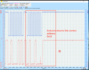

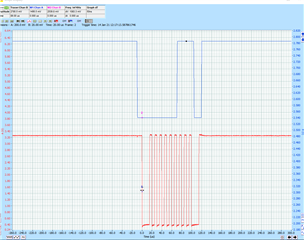

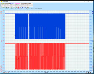

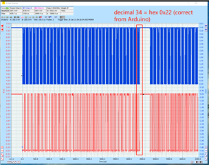

  • Here are the signals I got from SCL (red) and SDA(blue) for <TWI scanner demo>.
    meanwhile, here is my code <TWI scanner>

    Looking at the 9th clock pulse it looks like the SDA stays high, so there is no ACK here. Also, the data bits does not match address 0x20 (look like 0x03). Are you sure this is from the correct loop iteration? Can you modify your code to try to talk to only a single address at a time, so that you know that you are checking the correct one?
