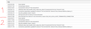

    Referring to nRF Connect from desktop, you see security level clearly stated in the short log. In this example I use a GLS example and configure nRF Connect to bond, connects and bond. Then I disconnect and reconnect. As you can see, log shows that link is secured, including security mode and level both when bonding and when securing the link after reconnecting. (I also added full log for reference - 6886.2021-01-13T17_53_34.999Z-log.txt, though that is probably not needed).

    Our device has some requirements where the app running on the central (ios/android only) has to ID its self after connection/bond. If it does not do this then it gets kicked (by the peripheral). I was hoping that the nRF Connect app on Android showed similar info to the same app on a PC, but it seems not. Getting NRF Connect on a PC to run and show the info in your log works fine, but requires the firmware on the peripheral to be modified to prevent the central getting kicked post-bond.
    This obviously then leads to production firmware not being what is verified - and it also gets more complicated for the verification team.
    If that's the only way of achieving this then fair enough, we will need to jump through the hoops!
    Karen
