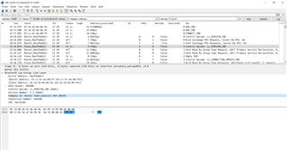

I would like to change the "Company ID" in my application so that it is no longer Nordic's (my application is based on the ble_thread_dyn_mtd_coap_cli example). I was able to change it in the advertisements (manufaturer data) but where can I change this value that is returned when connecting (LL_VERSION_IND)?
