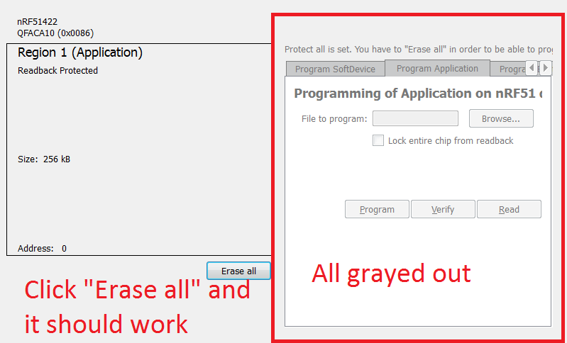

nRF51 Dongle Slave ?
Is it possible to use the nRF51 dongle as a slave ?
I have a nRF51422 Eval board that I am planning to use as a central device. Can I use the nRF51 as a slave so that I can connect to the dongle from the central device. So far I am not able to program the softdevice or program onto the dongle using the nRFGoStudio. It seems like a plug and go device.
