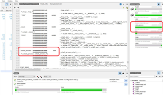

    Anyway. I was able to reproduce this now after updating from SES v5.32a to v5.34, and it appears to be caused by a bug in the "memory usage" viewer.
    Notice how the stack_process section is shown to use 64K of RAM while it's actually zero bytes as shown in the *.map file:

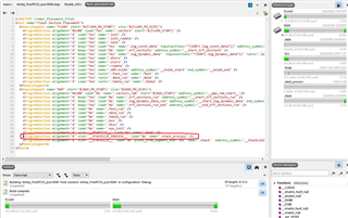

    A simple workaround I found for this was to place the .stack_process before the .stack section in the flash_placement.xml as shown below.
