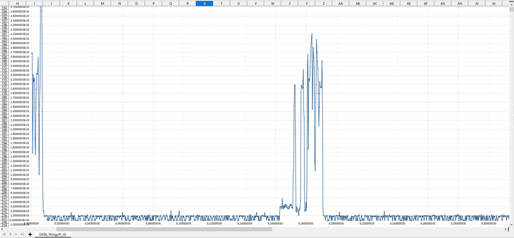

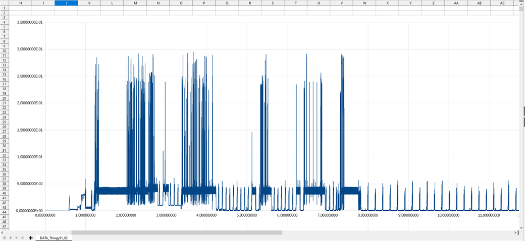

  • First 12 seconds (y unit Ampere, x unit seconds):
    Zoomed in between seconds 8 and 9:
    The duration of a 40-50 mA peak is about 0,02 seconds. What could it be and how can I turn it off? As far as I know, the sensors do not consume so much power. There is also 1 mA current consumption in between the 40-50 mA peaks, which is much. Where could it come from?

  • I did the plot with 3000 measurements per second and got an average current (calculated by multimeter) of 6.5 mA.
