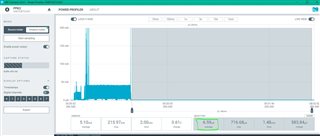

I used PPK2 to test the PSM mode current of nRF9160 is about 7.09uA (as shown in the figure below),but the eDRX mode current has not been tested successfully.

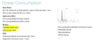

I saw on a Nordic PPT that the current in PSM mode can reach 4uA, which is a bit different from the 7uA I measured. Is the 7uA I measured is normal? It is 3uA different from the data on the Nordic PPT. Is this caused by the accuracy of PPK2?
