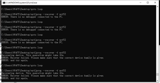

" JLinkARM DLL reported an error" On NRF52832, J-Link V9 Programmer
Our custom board (nrf52832, S132) seem enter to the read back protection, J-Link could not connect to the target in any ways.
We tried the command "nrfjprog --recover" to fix it. However, the " JLinkARM DLL reported an error" still happened.

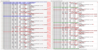

Here is my information and error log:

Can anybody helo me, please!!!???

  • Also, we change a computer with a lower nrfjprog version of 8.4, and run the same command, the error log changed to:
    nrfjprog --recover -f NRF52 --log
    nrfjprog verion 8.5.0

    Of course! We tried your suggestion first time, and the .bat continuing in looping almost 60 times! The cmd always showed the same result as "Recovering device. This operation might take 30s.
    ERROR: Recover failed. Please make sure that the correct device family is given
    ERROR: and try again."
  • It shouldn't take 30 seconds when you power off the device. Can you please disconnect all other nRF devices connected to that computer? When no devices are connected, the script should run through several times per second, giving an error:
    ERROR: There is no debugger connected to the PC.
    The idea is that you then power on the DK, and then maybe the debugger can catch on to it before it locks down. If it doesn't work, it will start the 30 seconds. Don't wait for this to finish, just power it off again immediately, and try again. Basically, leave the  script running, and spam the power switch quickly on and off.

  • We compared a normal board with the locked board excuting the recover command, here is the log comparison:
    It looks like the normal board could access the AP reg after DP reg, however the locked board always hooked by the DP reg accessing.
    I discussed this with a colleague. I forgot that you used a custom board, and hence an external debugger.
    Can you please try to only power cycle the nRF52? (while running the script)
