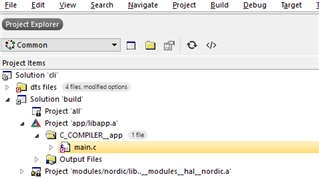

I can only see the conf files and other yaml files when i open nrfconnectsdk sample in Segger embedded studio IDE.Where do we exactly write our application code?Application code might be running a motor based on BLE command from a central device.
The main.c file is normally located in the src directory in the samples. In SES, you should find the main.c source files under Project 'app/libapp.a':
I would highly recommend you to have a look at the nRF Connect SDK tutorials. Specifically, nRF Connect SDK Tutorial - Part 1 describes how to setup a new project in nRF Connect SDK.
