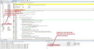

    sd_ble_gatts_hvx() may get stuck with the NRF_ERROR_BUSY error if you're calling it from an interrupt context as it may block the BLE_GATTS_EVT_HVC Softdevice event from ever coming through. A solution to this can be to send the data from your main loop instead, and either use a flag or a semaphore to know when you have received the BLE_GATTS_EVT_HVC event.

    I do not think I am calling it from an interrupt context. In the BLE_GATTS_EVT_WRITE event where I 'call' the send data method, all I do is invoke a timer. When the timer expires, it calls the send data. It is there where I get three indications out and then it stops.

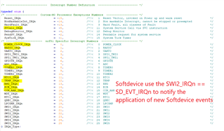

  • Application event comes from the interrupts sources listed in  the nrf51.h header. I've highlighted those that are reserved to the Softdevice in the image below. Interrupts reserved by the Softdevice are proccessed in the background without invoking the application.

     The app will wake up on the SD_EVT_IRQn, and then start to poll the Softdevice event queue (BLE_GATTS_EVT_WRITE, etc). It's the SD_EVT_IRQn interrupt that makes the app tor return from sd_app_evt_wait().

     After any of the interrupt shown above, so you will still need to use a bolean flag if you want "my_command_handler()" to only be executed after a certain event.

    I recommend you review the existing softdevice_handler.c implementation to see how it's done there. You may also want to read up on the ARM Cortex M exception model to get a better understandig of interrupts work on this chip.
    sd_nvic_GetPendingIRQ(SWI2_IRQn) is always going return false because the interrupt pending bit is cleared as soon as the interrupt is serviced by the  SWI2_IRQHandler (Note: SWI2_IRQHandler  is redefined to SOFTDEVICE_EVT_IRQHandler in sdk code). It only makes sense to use sd_nvic_GetPendingIRQ() if the interrupt is masked (ie temporarly disabled)
