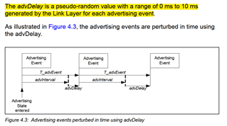

How do I eliminate advDelay inserted in advertising events of S132
We need to accurately control the time when the Bluetooth advertising package is sent out,
so that the two slavers can simultaneously send the beacon data to produce the signal overlap area, so that we can clearly know which slaver the label is near.
In S132, is there an advDelay inserted before sending the first advertising package?Is there any way to send the broadcast packet immediately without delay?
    Yes, this advDelay is part of the BLE specification, and thus is present in all of our SoftDevices - since they all conform to the specification.
    Unfortunately, there is not. This delay must be present in all BLE conforming devices. If this behavior is paramount to your application you might have to look into using a proprietary radio stack, in which you could implement this however you would want.
