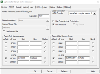

  • I have similar code (with changes related to the PHY).
    The code includes 5 GPIOTE events and when they are triggered, the NUS send a msg over BLE.
    It works with all the 5 with 52832.
    With 52840 it works only with 1 GPIOTE and the msg is LE CODED as designed.
    When I have more than 1 GPIOTE, the code is crashing on RAM and I don't know how to select the correct value (if this is indeed the reason)
