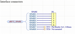

Where do I find the information required to create a 'NEW' I2C device and assign it to nRF5280 P0.26/27/28 as SCL/SDA/INT Thanks
Hi Kevin,

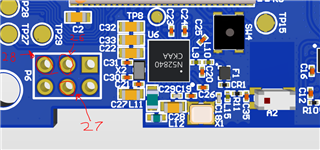

There is some limitations to what is available in terms of IO on the Thingy 91, P6 connector interfaces with the nrf52 on the Thingy91 product. Is the plan to use an external sensors or interface?
Pin map overview: Nordic Semiconductor Infocenter
Connector overview: Nordic Semiconductor Infocenter
Using NCS you can add something like this in the .dts or .overlay file
&i2c {
status = "okay";
sda-pin = <26>;
scl-pin = <27>;
};Here is a different Devzone case that might be of interest: Nordic DevZone (nordicsemi.com)
