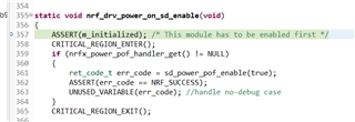

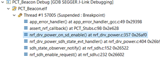

    Below is the stack trace when the assert traps the error
    And further down is a screen shot of the firmware that fails the assertion.

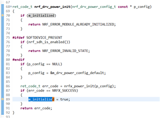

    In SDK v16.0.0, one of the only places I see that the variable 'm_initialized' is set to true
    with my specific SDK configuration is in this function below:
    I call 'nrf_pwr_mgmt_init()' before 'nrf_sdh_enable_request()' but do I also have to call 'nrf_drv_power_init()'  ?

  • Hi RMV,
    I don't think the nrf_pwr_mgmt_init() is related to the nrf_drv_power library.
    Could you let me know what exactly you are doing with the nrf_drv_power library  ?
    I would suggest to have a look at one of our example in the SDK that uses the nrf_drv_power , for example the usbd_ble_uart example where we uses both the softdevice and the nrf_drv_power to handle the interrupt when USB power is plugged.

    The only reason I did so was because the call to nrf_sdh_enable_request() ended up (via one of its registered handlers) making a call to 'nrf_drv_power_on_sd_enable()' which, as I indicated before, fails because the variable 'm_initialized' is FALSE.
    And this variable is only ever set to TRUE if the nrf_drv_power module is initialized....
