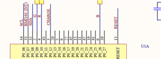

I have been using NRF52833 DK for many applications - such as get a battery voltage - which was great using SDK. Now, I moved to my own PCB which has got NRF52833 chip as well. I am finding some issues to run the firmware I developed on the DK. The firmware I developed is based on a SDK 17.0.2 project example which is in examples\peripheral\saadc\pca10100.
The first issue I have is with NRF_LOG. It doesn't work anymore. I don't see any data on the terminal.
My question is what do I need to do moving from the DK to my PCB? Sorry if this is a vague question, I am new to firmware development and I am learning Nordic environment.
The only thing I did moving from the DK is I configured the pins according to my PCB. I am wondering if those pins aren't considered and overridden by what's define in for example 'boards.h'.

    Apologies, it is not correct I am using more than PIN12. I meant I am using only PIN12 in the firmware. Here is my PCB schematic. I have a BMI160 sensor connected to the PCB as well.
    For now I am running the battery firmware only. It is a rechargeable battery. The firmware gets the charging status and the battery level. Here is a bit of my code:

    Did you replace the nRF52833 DK board file with a custom one altogether?
    No, I didn't. That was my wide question about what I need to do moving from DK to my board. What do you mean by 'board file'? Could you point me to it please?
    About the NRG_LOG, I wish to keep using the UART instead of using the RTT. I see below it is using PIN 6 and effectively PIN 6 is taken on my board. Can I use another PIN for NRF_LOG_BACKEND_UART_TX_PIN that is free, like P0_20?
    #ifndef NRF_LOG_BACKEND_UART_TX_PIN
    #define NRF_LOG_BACKEND_UART_TX_PIN 6
    Many thanks
